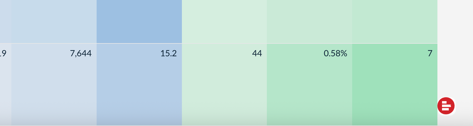

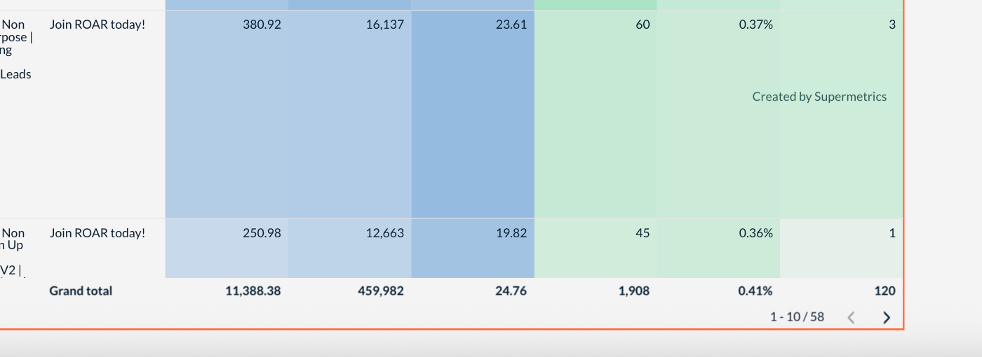

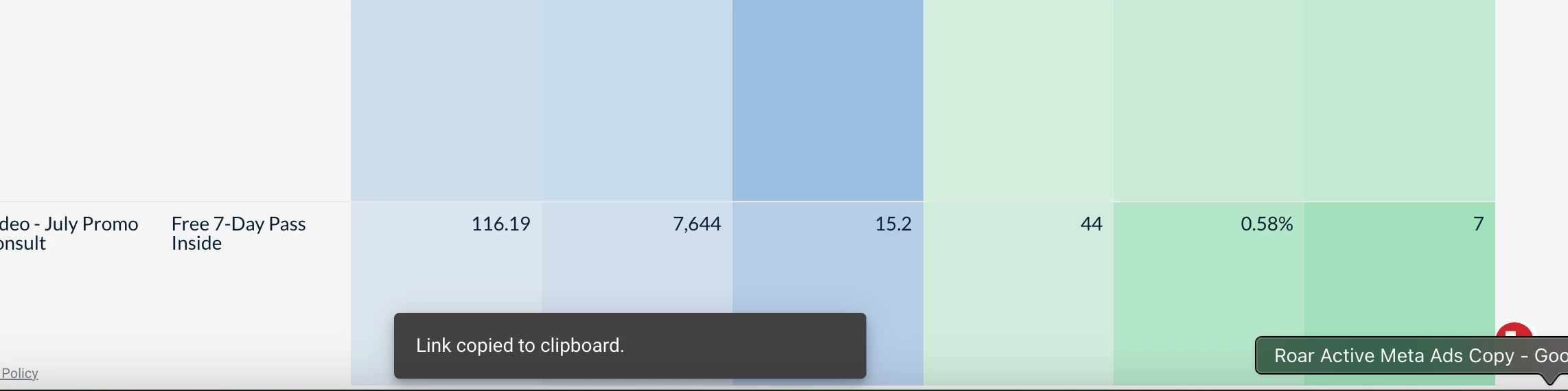

Hi there,
I am having trouble
How do we get the arrow on the actual view, it’s only showing up the edit. See images.
Thanks,
Nicki
