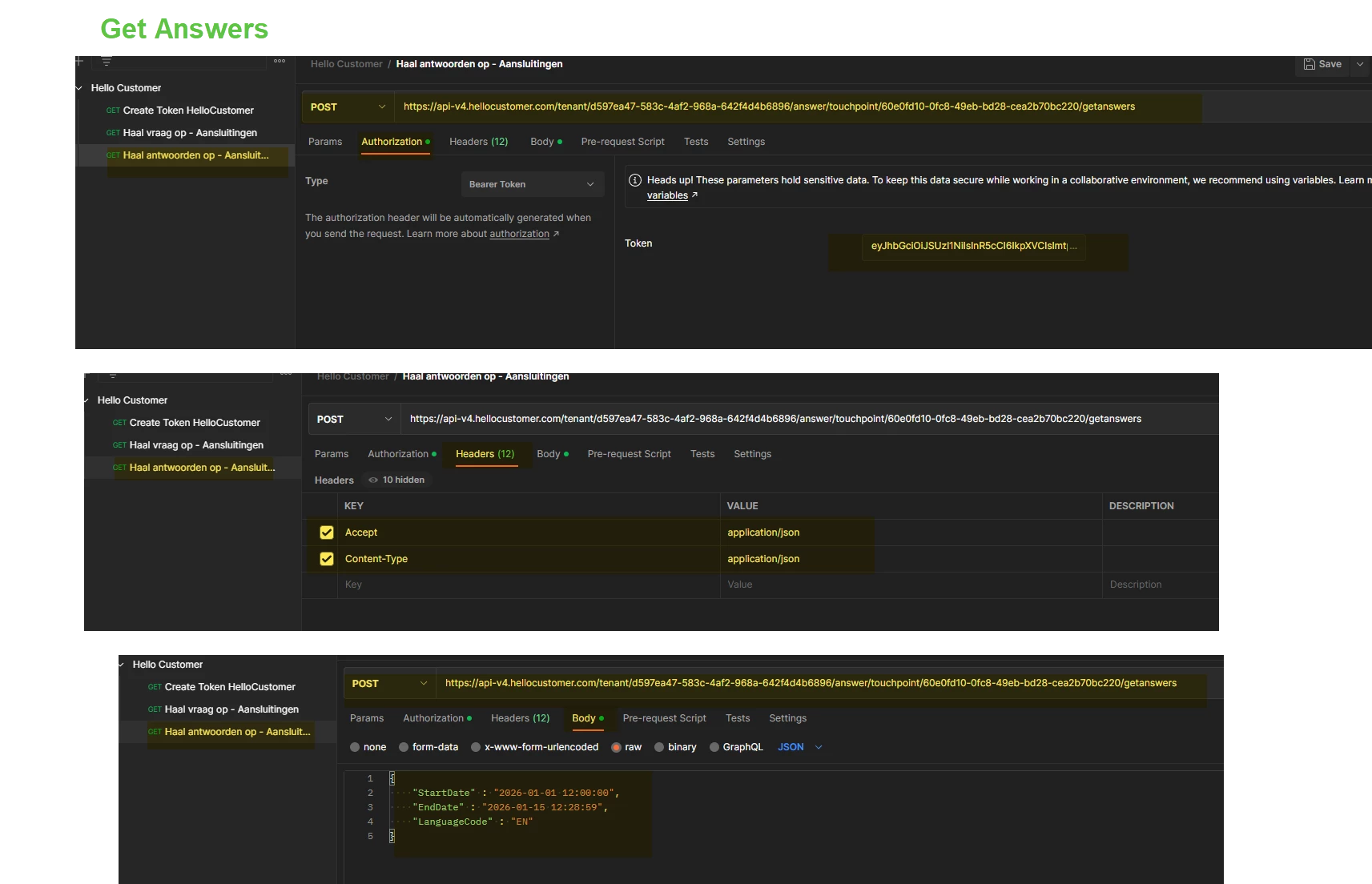

Hi,
I’m still fairly new to working with APIs and I’m setting up my first configuration in Postman. I’ve managed to connect and fetch data successfully.
I’m now trying to recreate this in Supermetrics’ Connector Builder, but I keep getting error messages that don’t help me much. Could you help me with a basic script based on my working Postman configuration (see screenshots)?
Thanks a lot!

I have worked on your feedback and eventually enabled Copilot to help me further. Unfortunately, I still haven't succeeded. Is this information correct?
Hello Customer uses:
OAuth2 client_credentials
no user
no authorization endpoint
no authorization code
no redirect
Supermetrics OAuth2 requires:
user authorization
authorization_code
redirect & callback
More info about the Hello Customer API https://hs.hellocustomer.help/knowledge/api-connectors-and-api-calls#Authentication

Hey ​@KennethDG ! Sorry for the delay here.
I took a look at the API documentation you provided, and that kind of authentication flow should be supported in our tooling with authentication type “single_step_oauth2”.
Here is an example configuration for that flow:

You can also request Client ID and Client Secret as an user input during authentication phase if you need to be able to create multiple connections with different credentials. Then the “clientId” and “clientSecret” values can be encrypted to be any value, and instead of {{oauth2.*}} placeholders you can use {{inputs.*}} placeholders. Let me know if this is the case for you, and I can provide more detailed example for that use case as well!
Hope this helps! If not, we can also have a call to go through your case if you’d prefer that!
